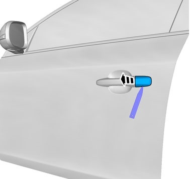

i think i should remove the plastic cover that hides the key hole... this can be done without removing anything else ... based on @AndreyS link to S60 guide.

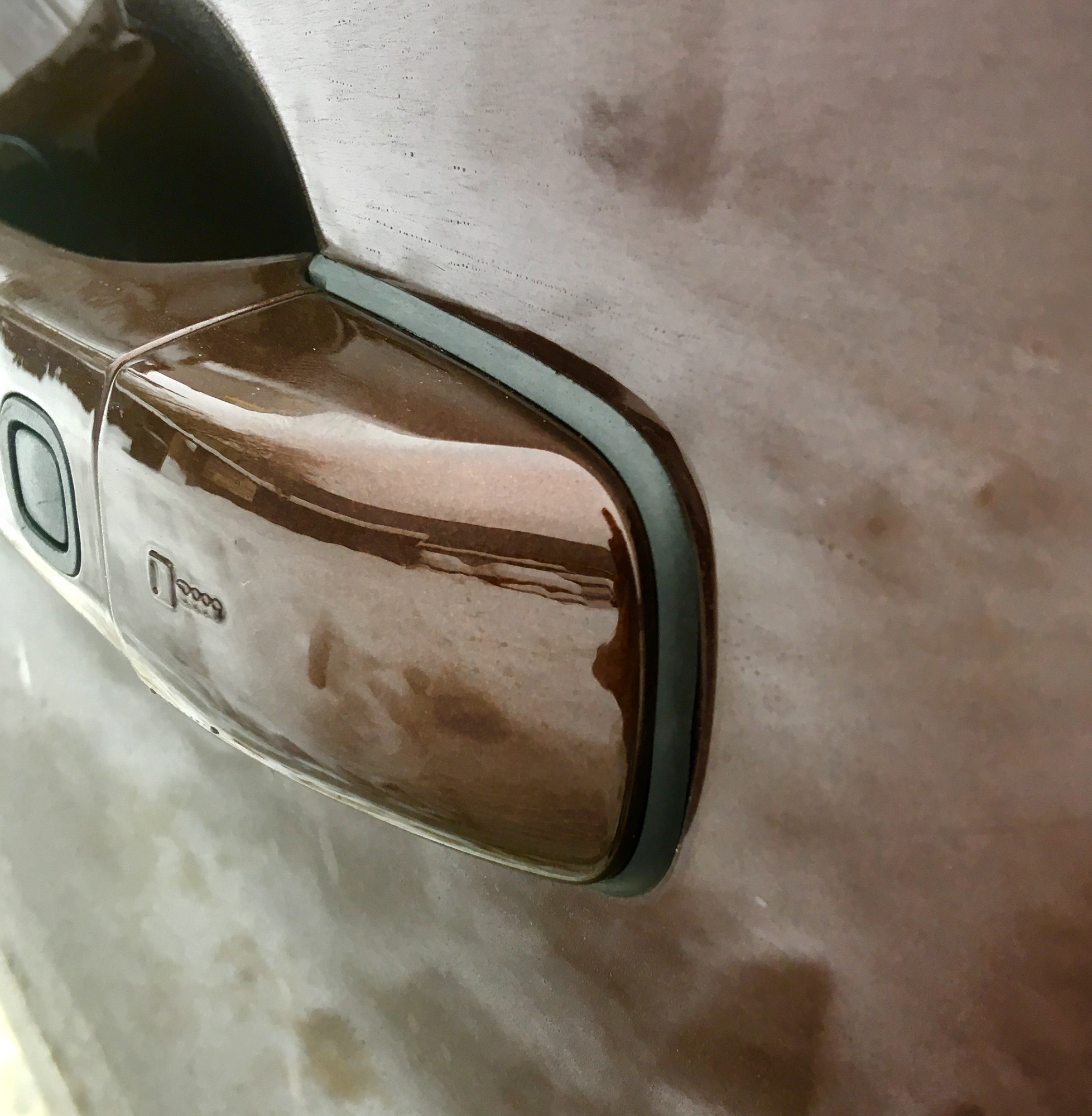

Hmm. Later i'll take a picture in daylight of my door handle. It seems that you have larger black part where small cap sits in.... but maybe that is only for keyless handels?
Не, на всех увиденных авто эта резиновая прокладка есть...

I was just outside and could not remove the cap with this method: IMG_2590.JPG.86ae093ec496a40ff8c49d78fd244d49.JPG
i could get the tip of the tool between black rubber and the cap but it did not came of. It just now have a bit of play compare with other door  caps

 Here is mydoor handle.
@kachijs, нсли не снимается белая накладка, то надо приступать к выворачиванию всей детали...

I have to go to shop then. I checked and that hole have some plastic ring inside and you have to have very tiny screwdriver to fit....
