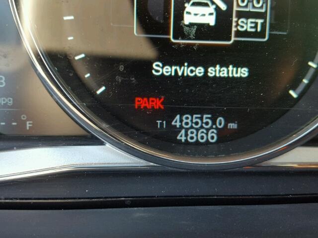

это у Веспер? знакомы тоже хочет купить эту тфт панель по 16500 но у него S60 2012 как подружить авто и панель, адапетром?
Изменено пользователем killroy
Ну, как..., Вы хотите в Тбилиси сделать , а панель с адаптером из Москвы заказать?
3 минуты назад, s.e.r.g. сказал:
Вопрос решился очень просто. VDASH может прошить панель на машины до 14МГ. стоит это 125 евро + надо с LS CAN 2 проводка кинуть.
итого на кругу получиться 16500 панель + 9500 прошить и 2 проводочка. 28 000 отличная конкуретная цена по сравнению с одной известной конторой которая с адаптерами продает комплекты.

In last few weeks we provided a "semi-manual" solution for couple of beta-testers. Due to the very high demand we have to put all other requests on-hold, until we develop fully automated solution for retrofitting TFT DIM thru VDASH. This will be rolled-out in two phases:
1. Sensus cars (XC/V70III/S80/XC60 MY12-, S/V60 MY11-) - this one will come first, likely within first half of January. The solution is very much stable and mature. Note that it covers also the conversion of the cheaper DIM version (introduced in MY15) with single central gauge. It too can be upgraded to the TFT DIM. It's actually one step simpler, no modification of the wiring (step B below) is NOT required.
The end user price of this level one will be 125€ + tax (or equivalent in other currencies).
2. non-Sensus cars (XC/V70III/S80/XC60 -MY12) - this unique SW-only solution is still in the extensive beta-testing. We're experiencing some issues in manual-transmission based cars. It may happen that we may postpone the roll-out for manual cars, the automatic are coming first in couple of weeks.
In any case, the final cost of this product will be in range of 250€ + tax (or equivalent).
Stay tuned ;-)
In the mean time, you can get prepared - and proceed with some steps that are mandatory for each car (VIN) anyway:
A) the CEM unlocking process is pretty time-consuming, the CEM unlock takes 12 hours in average, count with 24 hours in the worst case. It has to be done once per each VIN. Your car has to be properly charged at all times, using a good charger (the one that can deliver 15-20A continuous current ideally). In any case, the CEM unlocking process can be paused and resumed at any time, e.g. 2-3 hours a day, etc.
В) get ready the with the new wiring (only cars MY13 or older) which requires two new twisted-pair between OBD connector and DIM plug:
DIM pin 7 <---> blue-black  OBD pin  6
DIM pin 8 <---> green black OBD pin 14
C) the TFT DIM hardware itself - there're numerous versions of the hardware available on the market. VDASH supports all of them - basically there are just two versions: automatic / manual transmission DIMs easily distingushal. Match it to your car before you buy.
Note that the DIM version for V/XC40 has physically different dimension and cannot be used for into x70/x80/x60 series.
